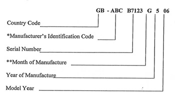

I have the HIN number
The month and year of build are in the HIN number although I confess I don't know at what stage the number is allocated and applied.
