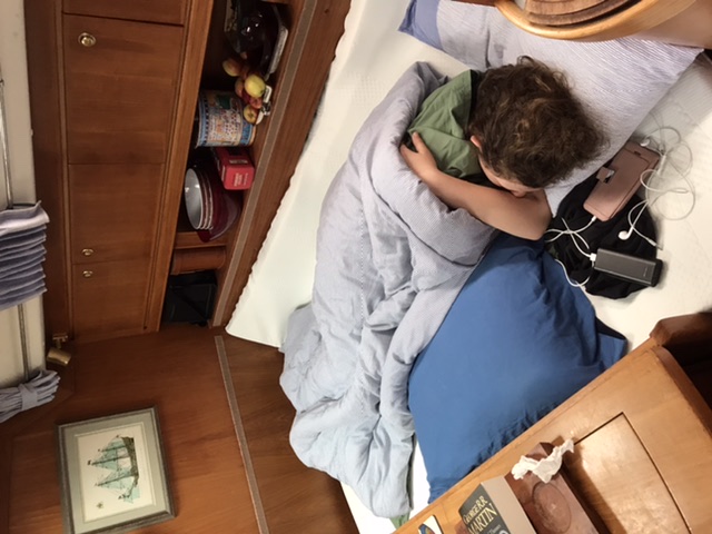

We have converted the saloon on the 35 very simply to a double berth. It would not do in very rough weather but is adequate for most conditions. I see no reason why you couldn’t do something similar to the 27. See picture of result. However you might find passage from the fore berth to the heads a bit tricky in the middle of the night in an M27, the port side option might be a little bit too cosy for a double berth!
