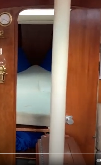

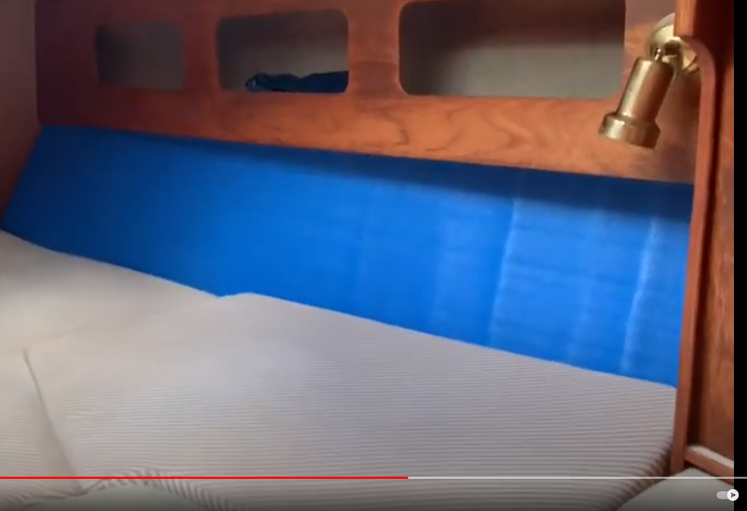

The first owner has modified the front cabin but cutting down the end of the starboard side wardrobe, removing the small vanity shelf and reversing the cabin door to open into the saloon. They have then built some sort of frame and extended the in-fill to cover the whole area thus making the bed a bit larger. It now comes to the door threshold (no floor space visible).
I've attached some screenshots out of a video. You can see where the cabinet/headboard (??) has been cut away on the starboard side.
My questions are:
- Is that wardrobe end structural? I'd say about 3 inches have been cut back. The boat was surveyed in 2015 and no mention of any issues.
- We would like to return to standard as the door opening out is wrong, gets in the way of the saloon, and my partner wants standing space to get into the forward berth. Would a joiner be able to rebuild the cabinetry or is this bonded into the GRP?

Adam, I don't think the end of the cupboard on the starboard side is structural and since they have only taken 3" away I wouldn't worry. A carpenter should be able to reverse this without too much trouble.
Pete
Thank you Pete, that's encouraging!

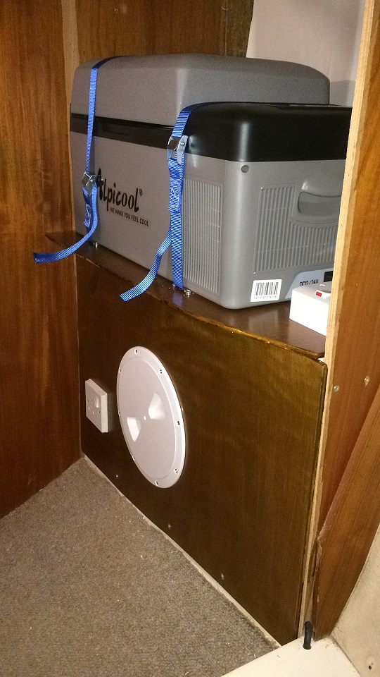

Great plan to personalise. We have take the stern cabin wardrobe out and installed a small freezer.
Great - use the space in the way it works for you!

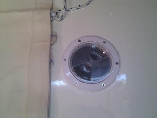

Adam, no problem with the tank and like Michael give it a dose of bleach each Spring. We did fit a water tight dinghy inspection hatch so I can see what is going on inside and clean the small "sand trap" that exists below the main fill pipe join. I also later fitted a tank sender gauge.
Pete

The tanks can be prone to osmosis, you'll know this if the water tastes funny.
I stripped mine last winter, ground the blisters out, filled and then painted with pigmented epoxy.
Took a week or so all in all, but a clean water source.
I also fitted inspection hatches, but I have had to use a sealant around the threads on the screw in lids as the lids are not water tight from inside to out.
