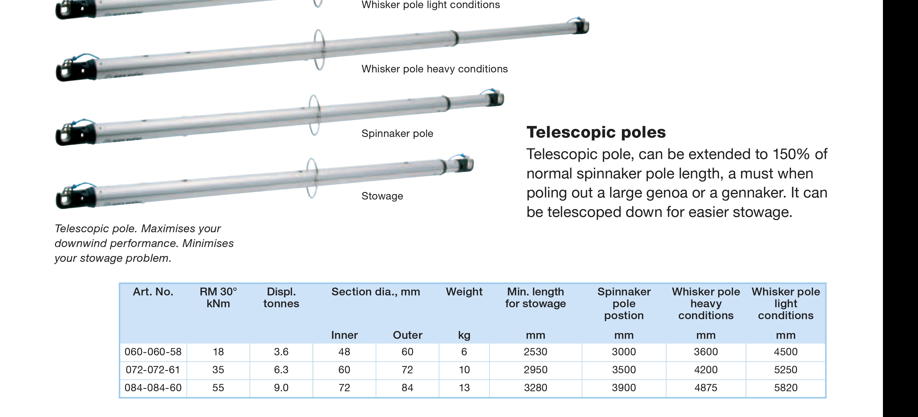

On the latest Selden brochure, I am after part number 084-084-60 (3.3m but extends to 5.9m). I've included an extract from the brochure below.
Can you confirm the outer diameter is somewhere near 84mm?

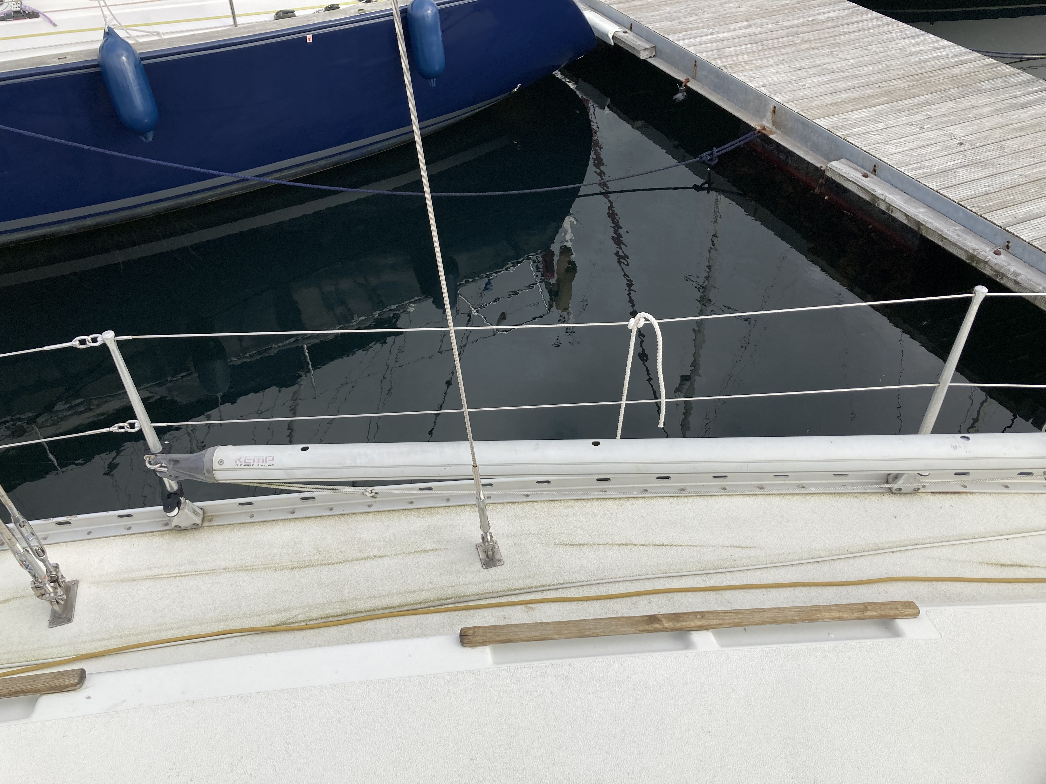

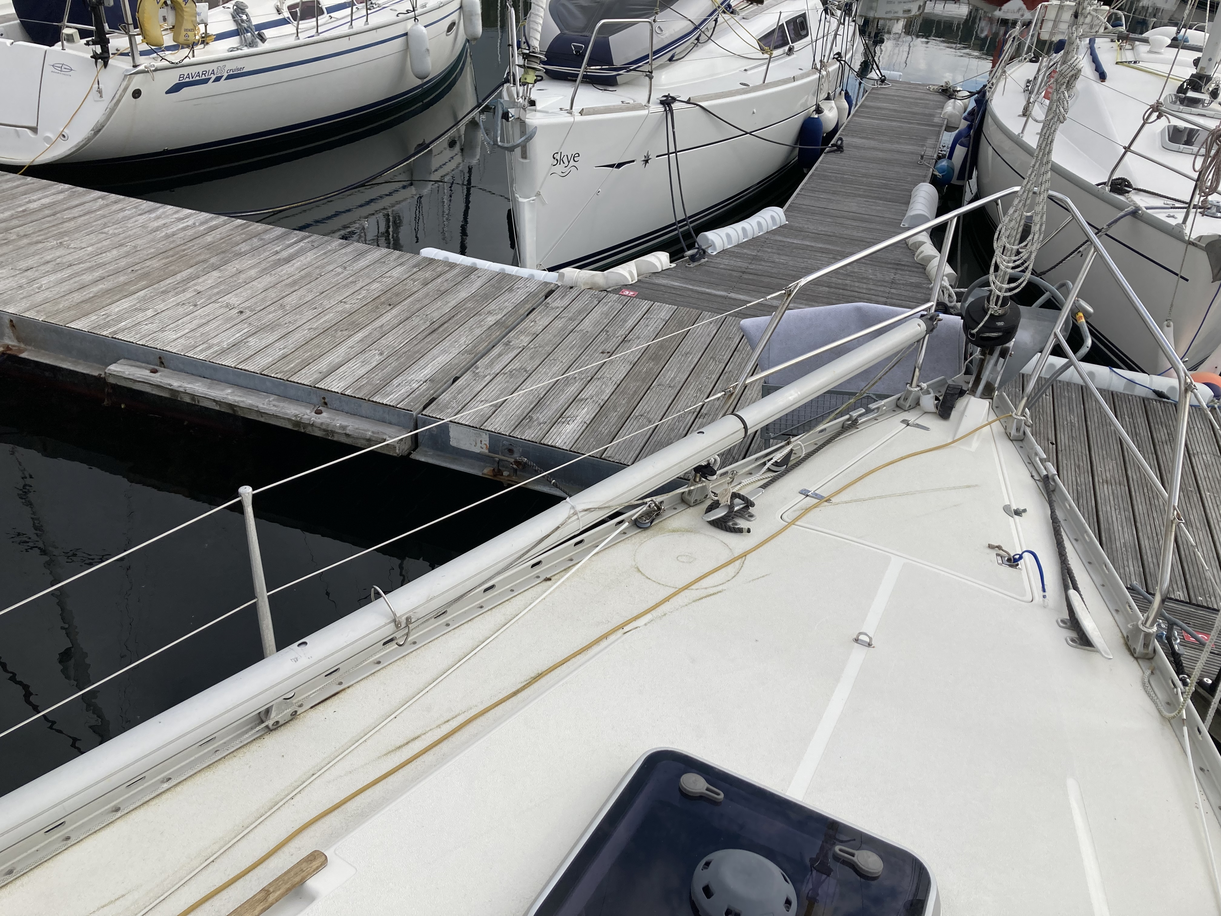

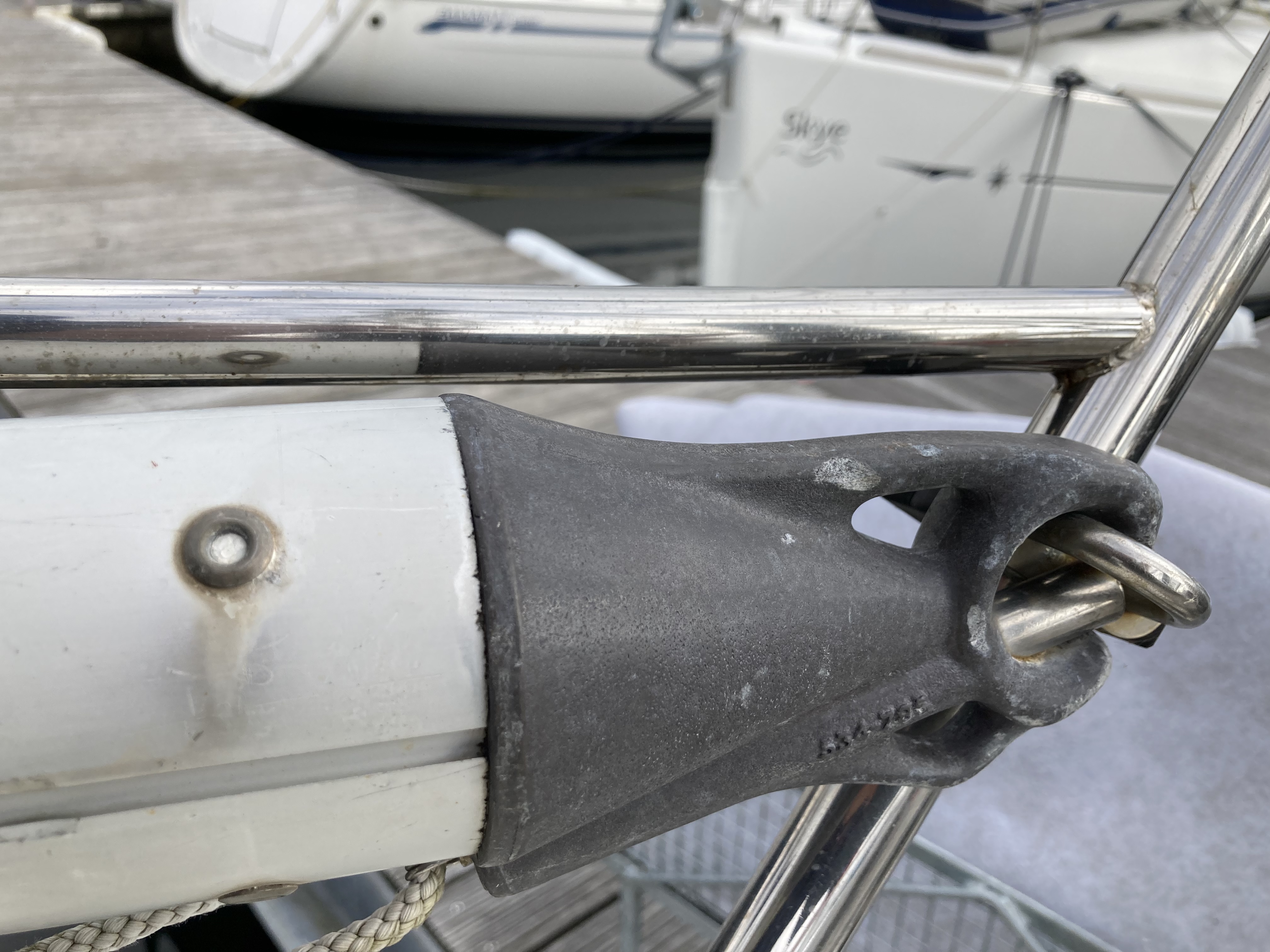

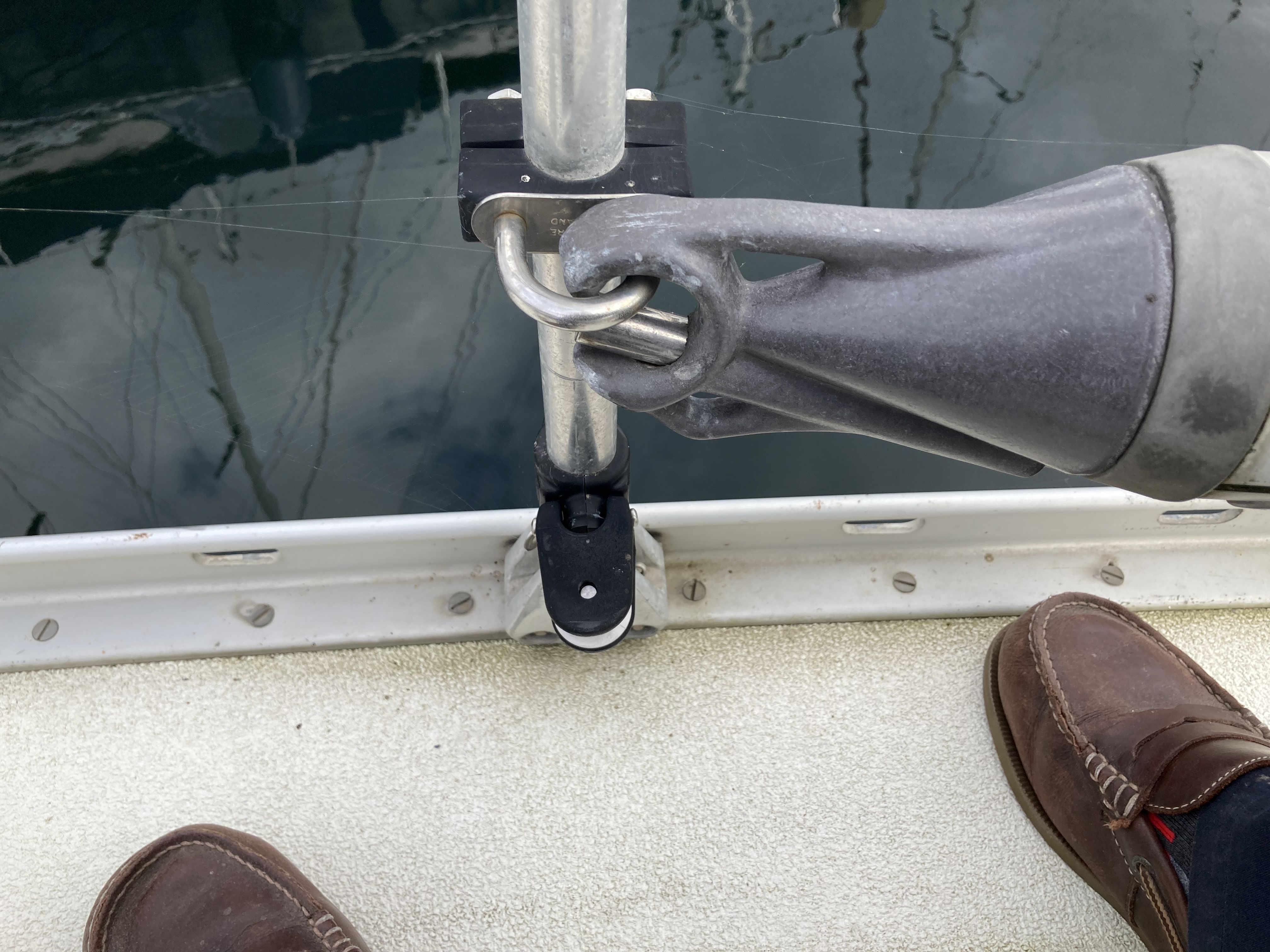

Tom I have added 4 pictures of the pole which show the end fitting etc.
John
John
