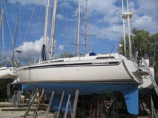

Hello forumites. I'm looking for a Moody 346 or possibly 34 in the spring.
Looking at those recently for sale, I notice many of the 34s have a metal strip/trim on the port quarter; a 90 degree, conformal piece of stainless steel(?). It only seems to be on the port side, not symmetrical (something with which I might struggle, aesthetically!), and not on every boat.
Can anyone shed some light on the purpose, and why it's not present on all boats? Is it an elective addition, a repair, strengthening? Does it cover some weakness or failure? It would be good to know before starting the viewing/survey process.

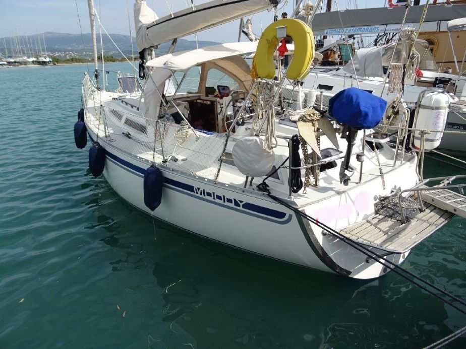

Thanks for replying. Here are some stock images, for reference. I hope they make it a bit clearer.
That makes it clear., though I have never seen it before on a Moody.
Sometimes added to protect the quarter of both GRP and wooden hulls from damage maybe when entering or leaving a marina pontoon berth, or stern-to mooring. May also protect against mooring line chafe to hull.
However if needed it may be fitted to both quarters.
Not really structural just damage prevention.

Hi,
I note that a kedge is stowed on the pushpit just above the offending bit of stainless - I suspect the stainless is there to offer protection from the cable when deploying the kedge, particularly as the added on bathing platform prevents deploying it directly over the stern.

Hi Joseph
I would say definitely added after purchase. We have a 34 and since getting into the Mediterranean could have done with this add on both stern quarters. We are currently in Greece and at least once a season when moored stern too on a quayside end up grinding one of these corners against the quay if someone catches our anchor or there is a very heavy wind.
It also would be invaluable to protect against the kedge anchor cable as Peter suggests.
So certainly not essential, especially if you aren't intending Mediterranean sailing, and odd if just one side, but no bad thing.
