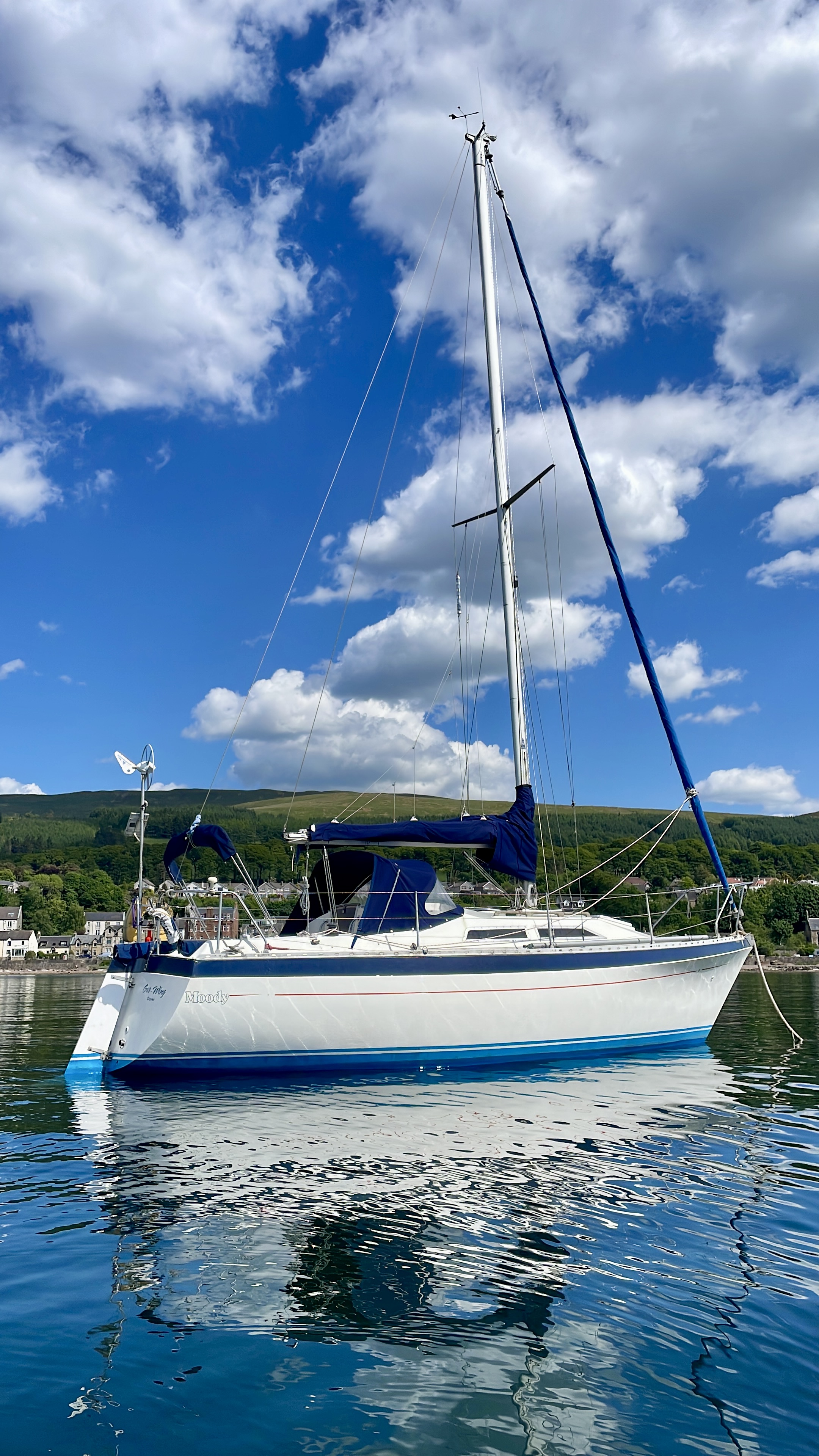

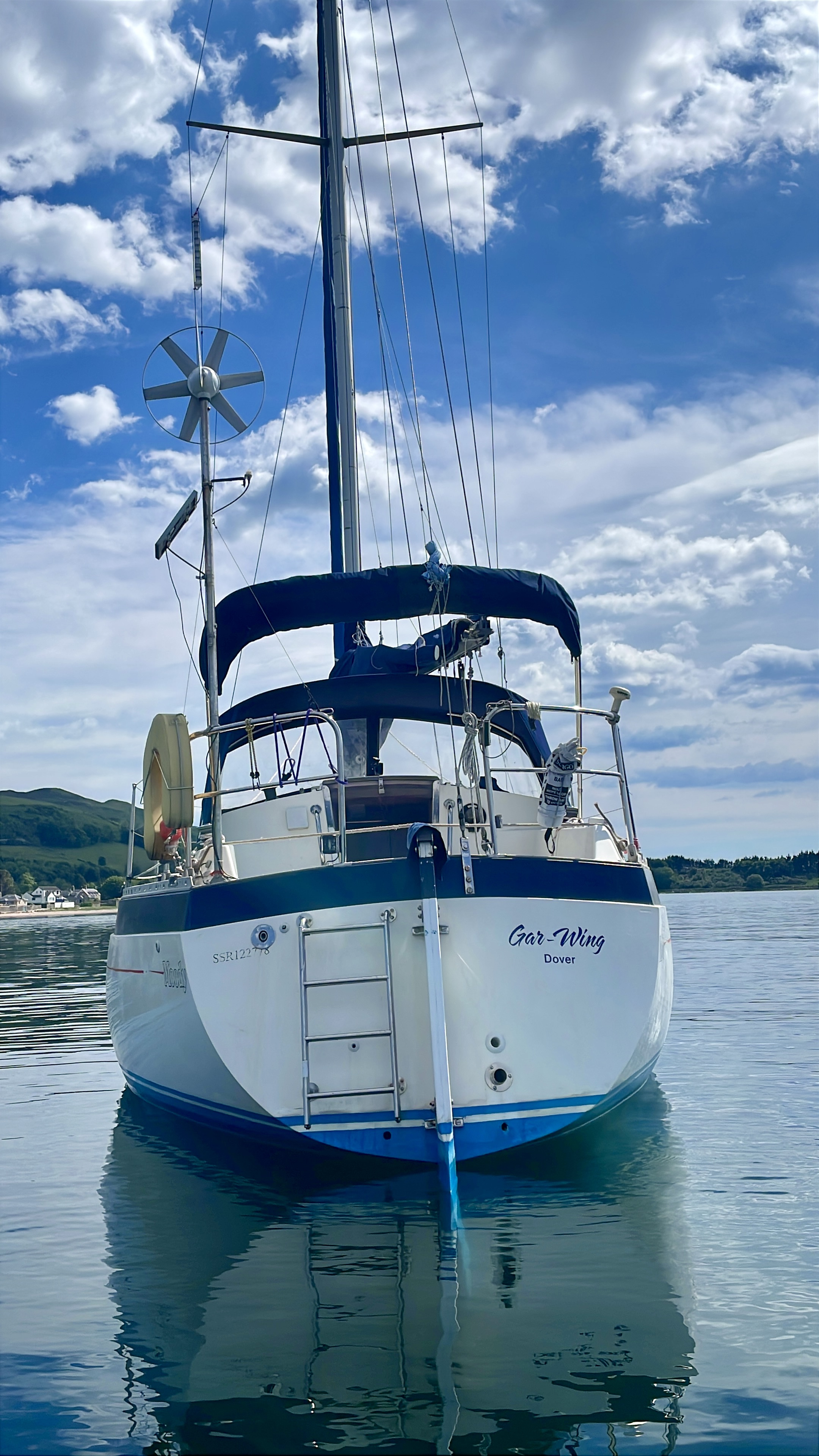

Hello
I’m looking to buy affect your moody 29
Has anybody experience of them and is there anything in particular I should look out for such as movement in the chain plates rudder stock or keelbolts etcetera
I would hope p get a survey done ✅
Any information and advice gratefully received
thanks in advance

The Rudder, is transom hung on pintles, so it's good that you can see and feel if there is any wear. They may rattle a little when moving under power at top speed, but that's not a concern, as long as you cannot feel any sideways movement (out of the water).
