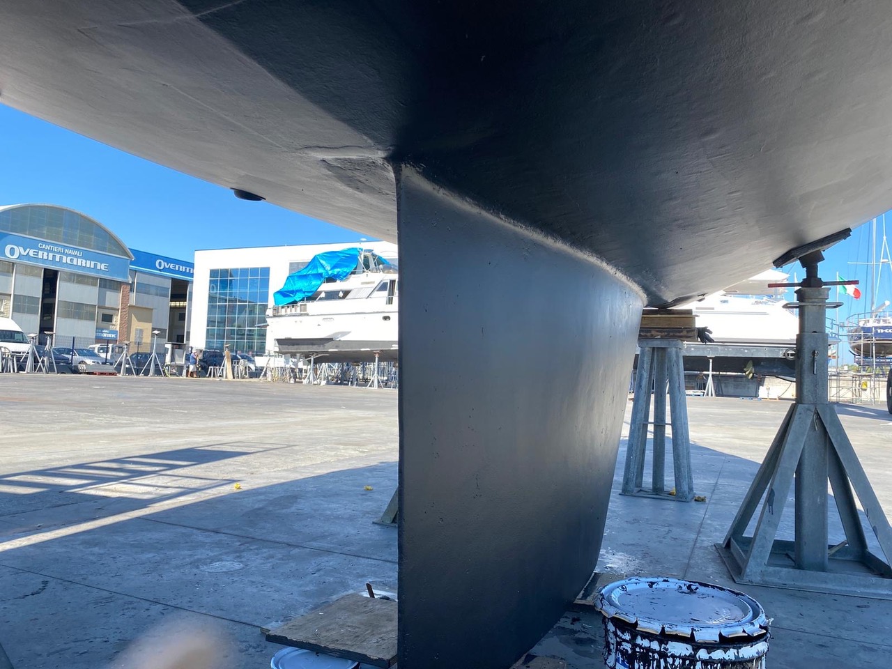

  • Issue. Some osmosis on the hull. See picture.

Osmosis never killed a boat and is treatable, but again, is a job for a grp professional.

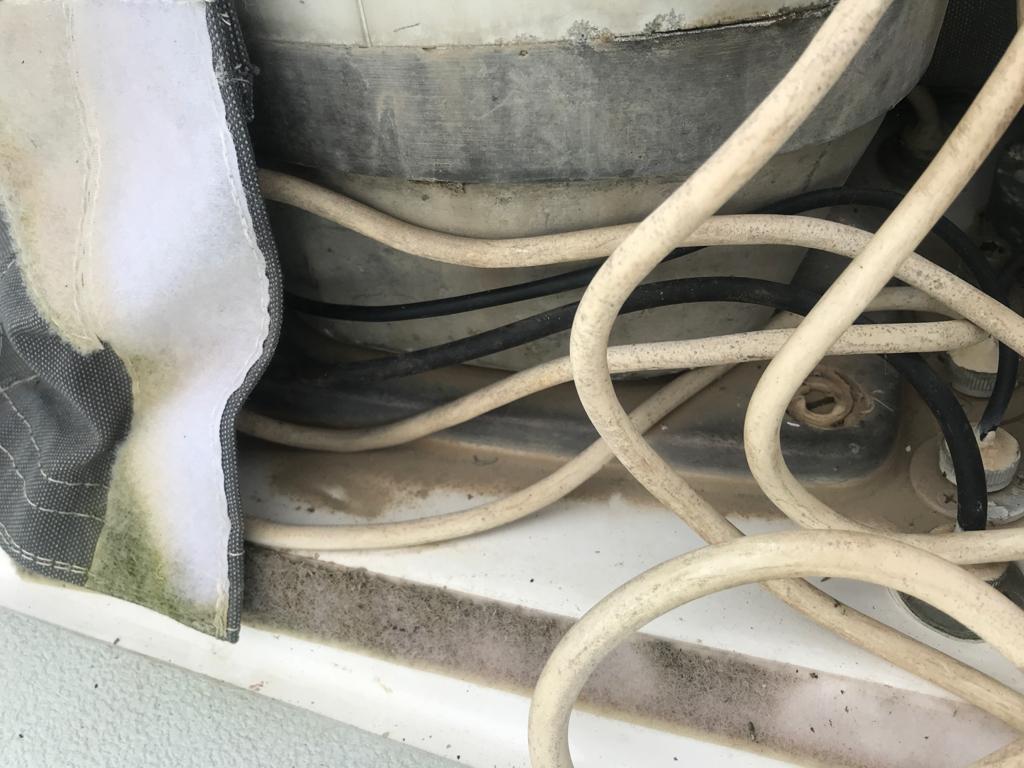

Pity there is no picture of the mast step to see how much the deck is depressed. I certainly agree with Peter that the best way would be to cut out from the inside. Do also check the condition of the mast strut (the end in the bilge) that goes from under the mast step down to the keel.
I don't know about the M422 but the M41 and M419 masts are very solid and heavy.
Micky,
Thank you for asnwer. The link is ok, they had a mistake, this is 419.

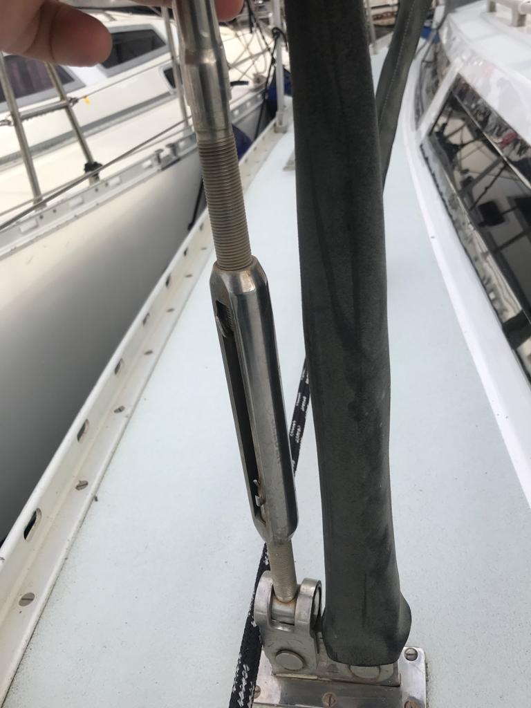

The photos I have about mast or rigin, is only this ones (see atached).
In couple days I will receive more information.
