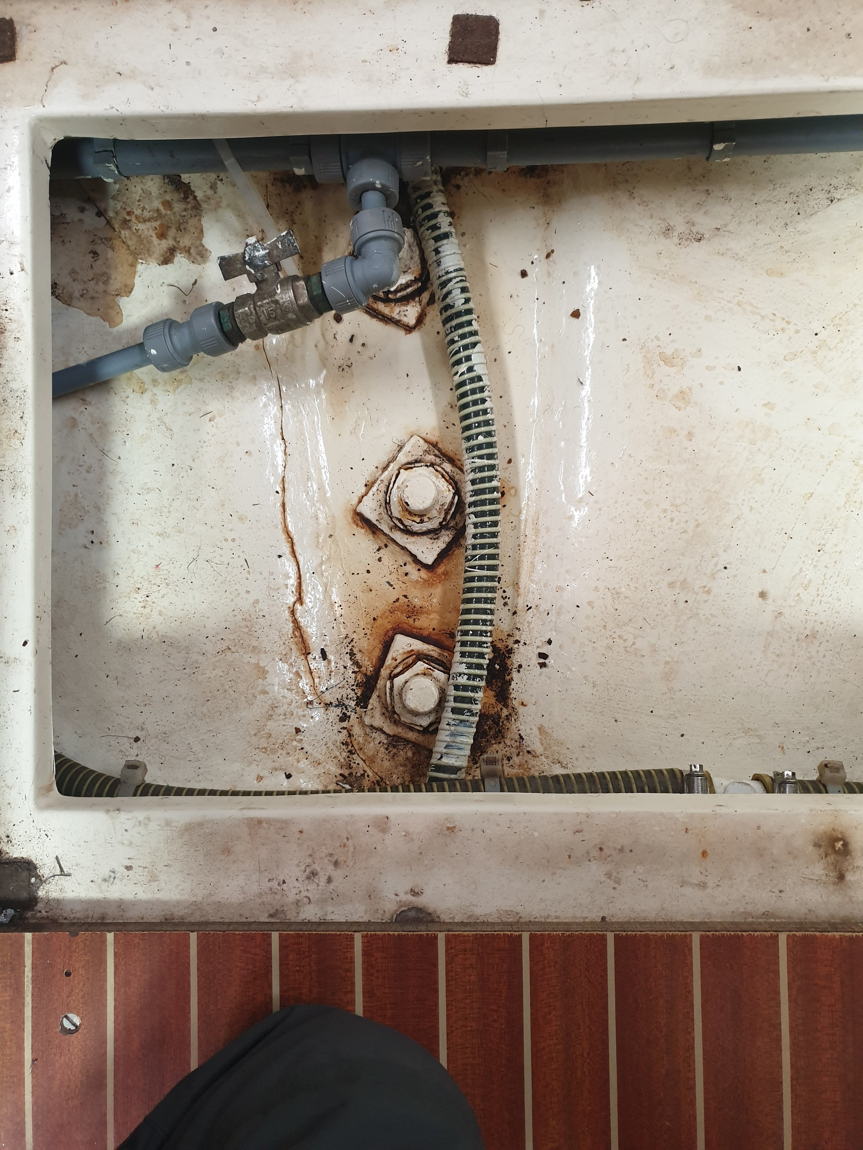

Many thanks both for your feedback, it is exactly what I needed. Pic of keelbolts attached, shall be covered in any survey anyways.

Hi Mike,
Judging by that photo, there's not a lot wrong with those keel fastenings. If you clean them up thoroughly and repaint with a tougher paint, e.g. Hammerite, they will last another 20 years. I believe Marine Projects used flowcoat because it is easier when they're already flowcoating the bilge, but it's a bit too brittle for painting the steel studs, nuts and backing plates.
If you want to know more about keel fastenings in Moodys, check here:
However, unless some of the other studs look a lot worse than those in the photo, I don't think you should have any concerns. Of course, it's always the least accessible ones that are in the worst condition.

Also a tad agressive, sorry. Just keen to get a solution. I sighted the keel bolts and was okay, the movement is something else.
