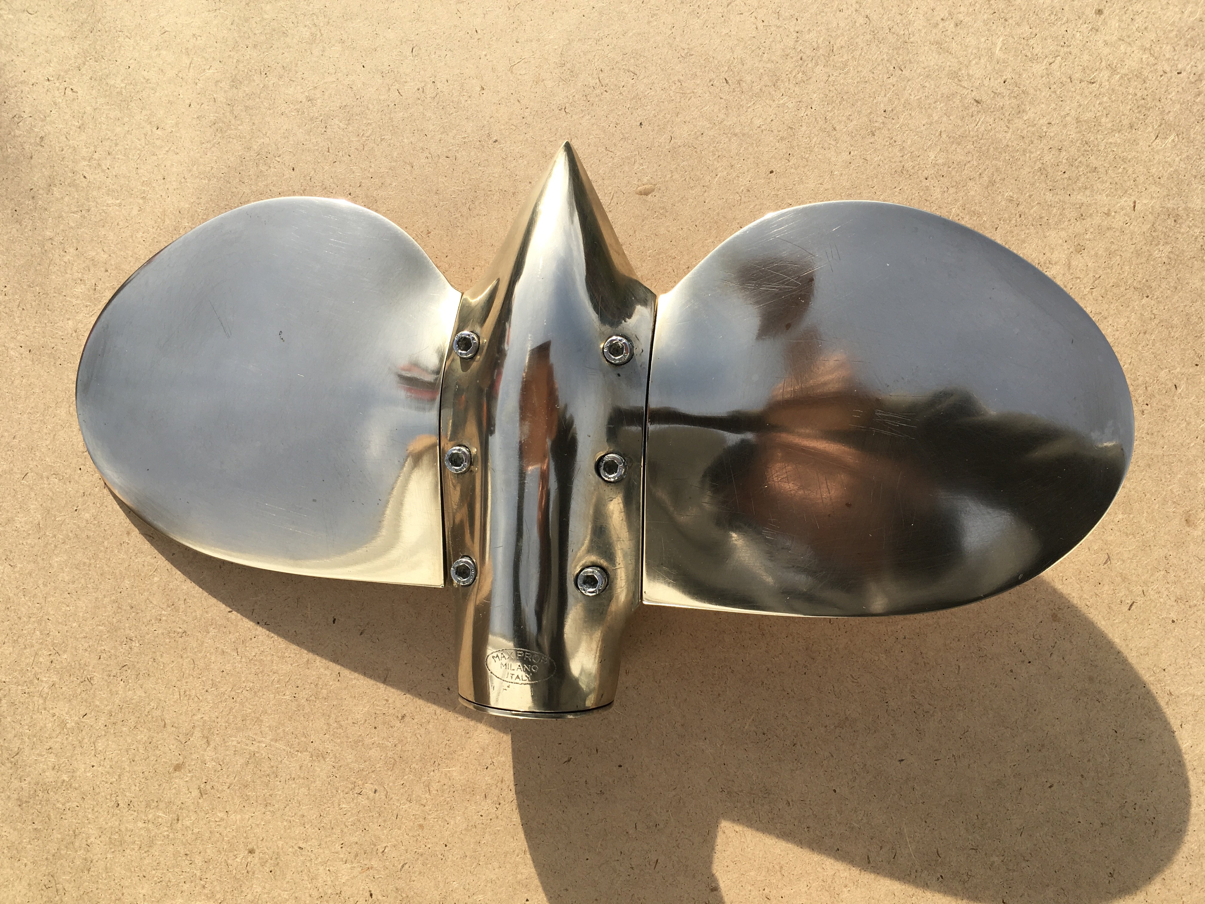

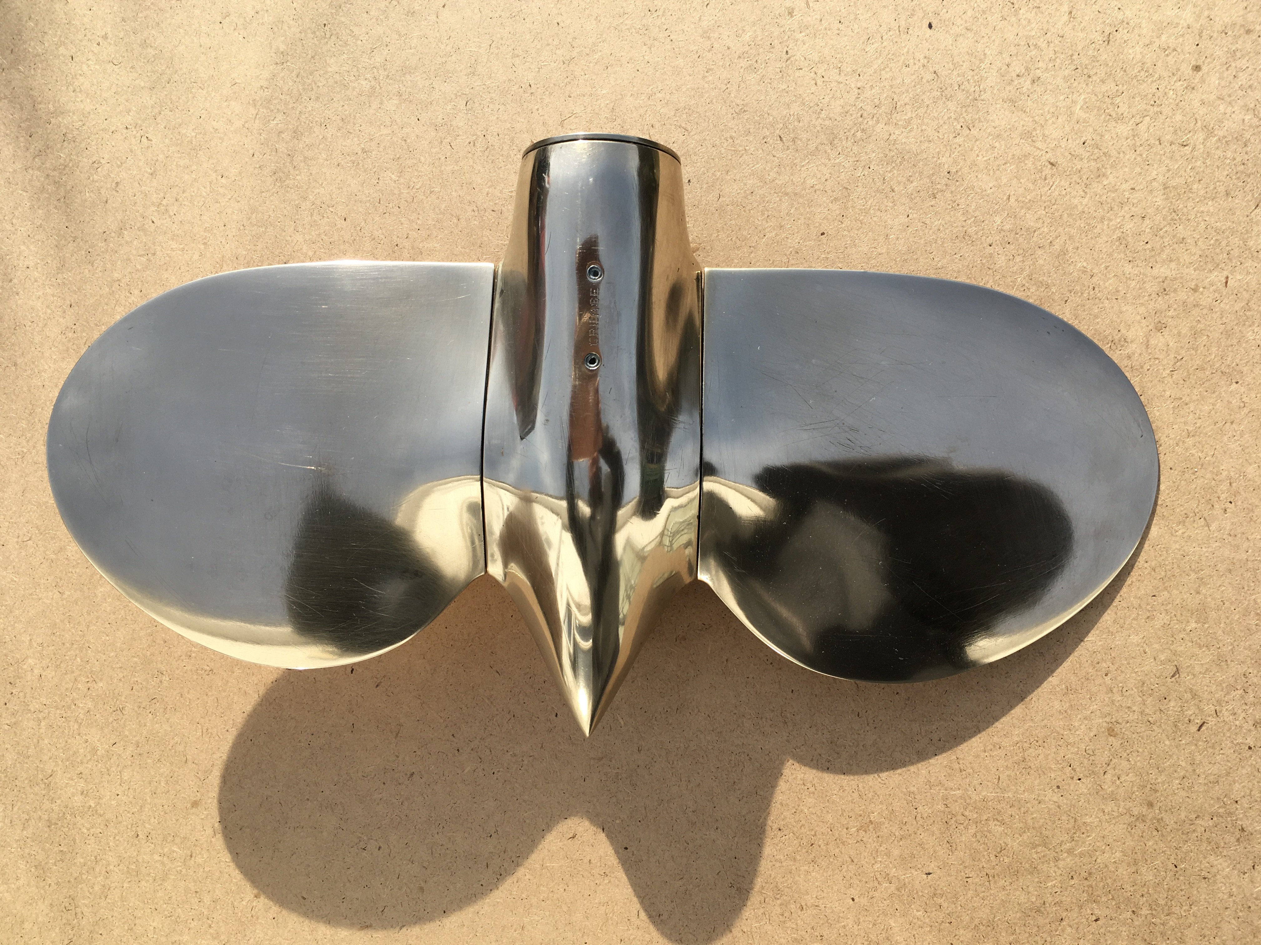

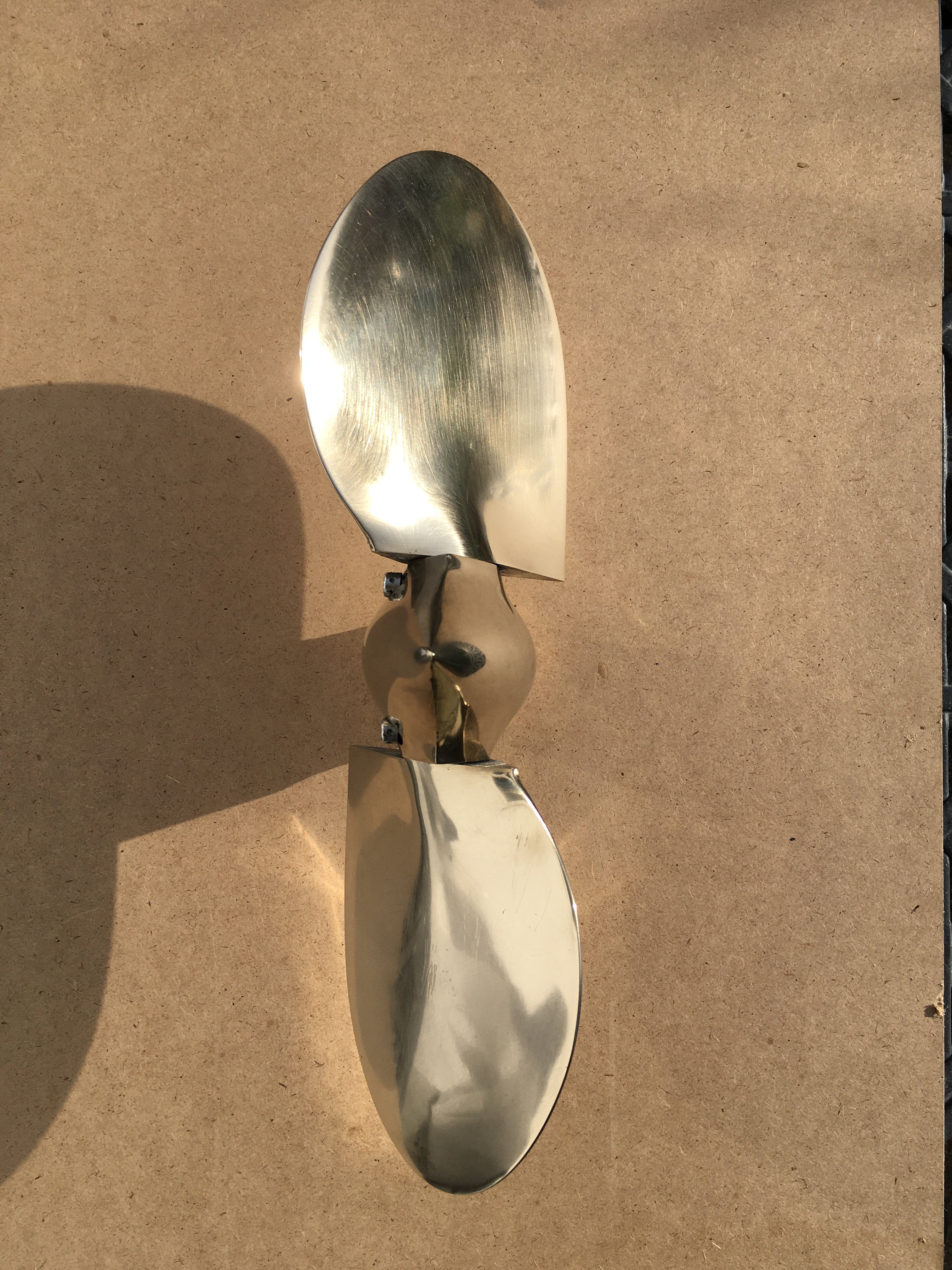

Max-Prop Bronze 16” 2 blade feathering propeller previously fitted to a Moody 336 with Volvo 2003 and 1” shaft. Reason for sale new engine and 3 blade propeller currently being installed. The prop is in good condition and has been working efficiently up to present date. This model of prop requires shaft anode protection and annual filling with grease. Supplied with fitting and set up instruction booklet. Weight 6 kG’s. Price £500 . Collect from Poole Dorset or carriage at cost.

What does it measure blade tip to tip
Hi Stephen,
Tip to Tip 16 1/4 inches, (413 mm).
