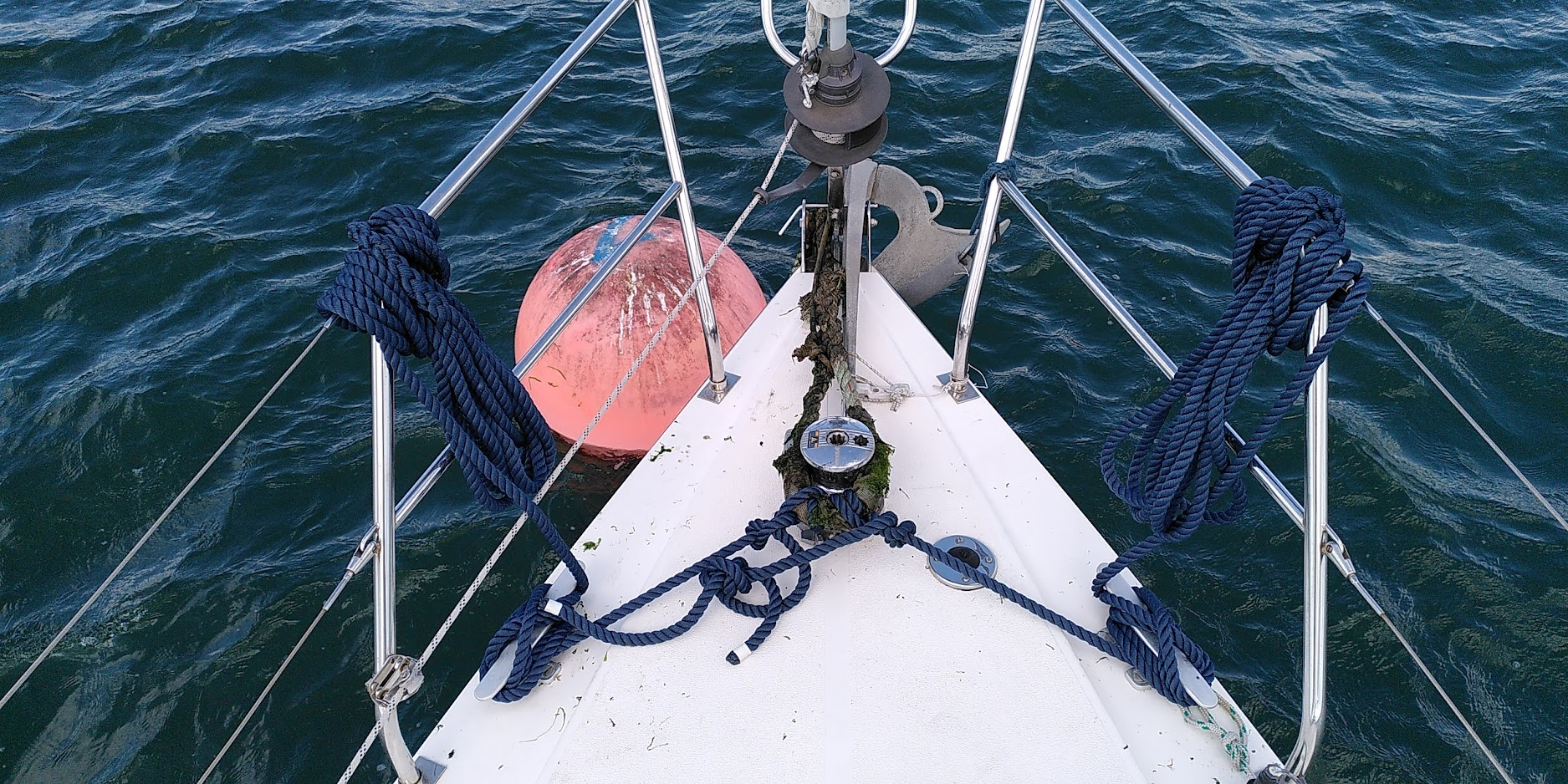

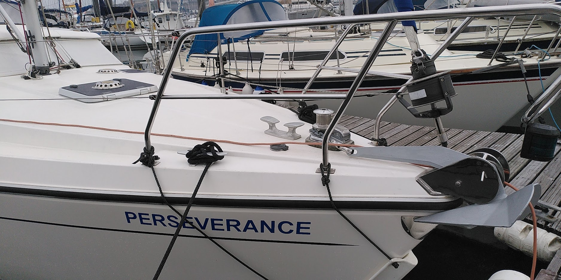

Some E33s have centre line bollard type cleats, as per the one I spotted in PLymouth over the summer. We left ours on a swinging mooring for a month and, although it was a rope rather than chain line, I used a bridle of individual lines to the mooring cleats on the toerail, with the loop over the windlass for good luck. That way, there were 2 line connections to the mooring, keeping the line centred, but should either fail we were still attached, with some of the load transfered to the windlass to keep it on centre
