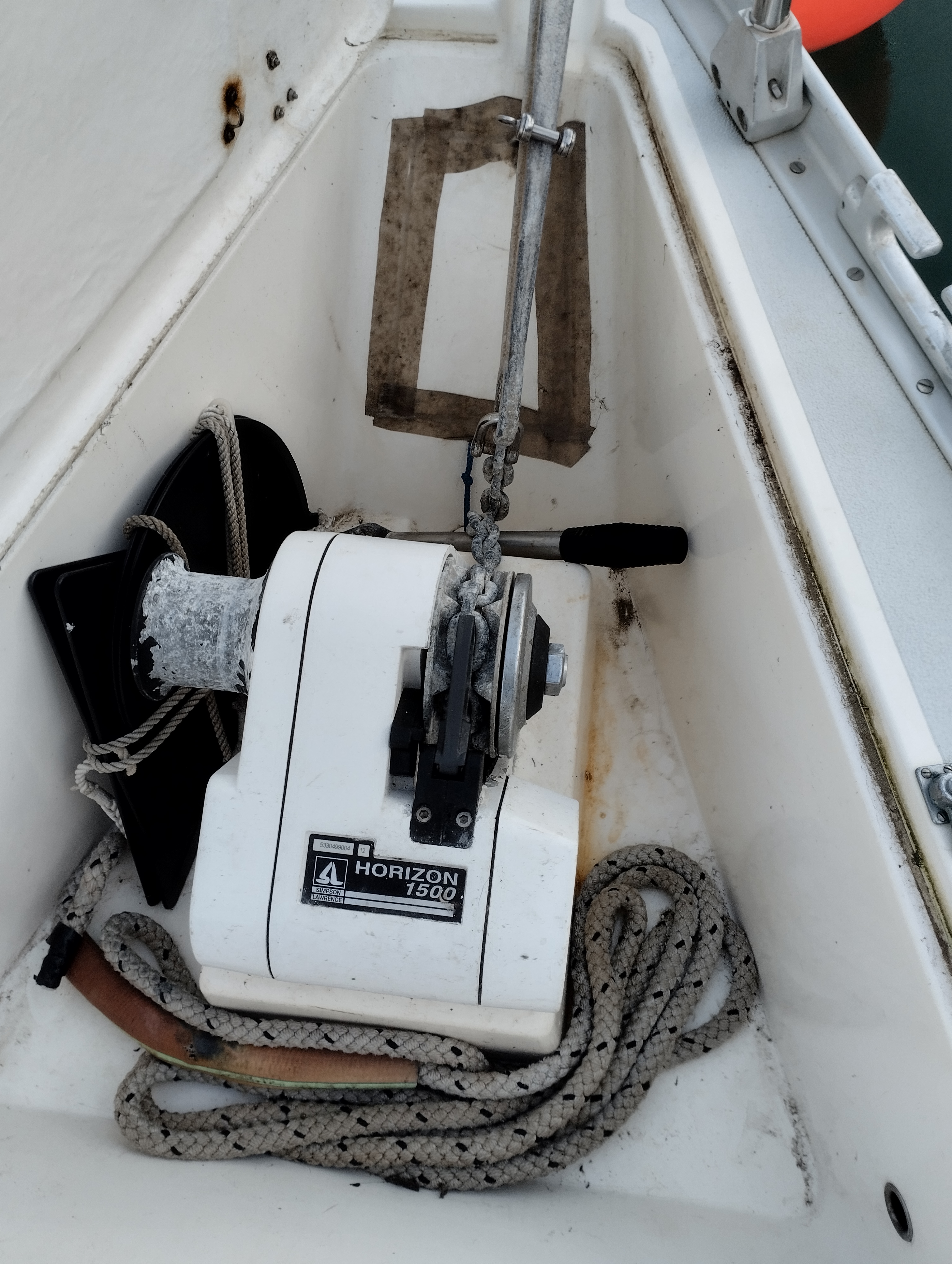

Could you tell me the exact chain size you use in your horizon 1500?
I happen to have the same windlass but am not sure about chain size...and my chain needs to be changed. Also I am not sure every horizon 1500 uses the same chain size.

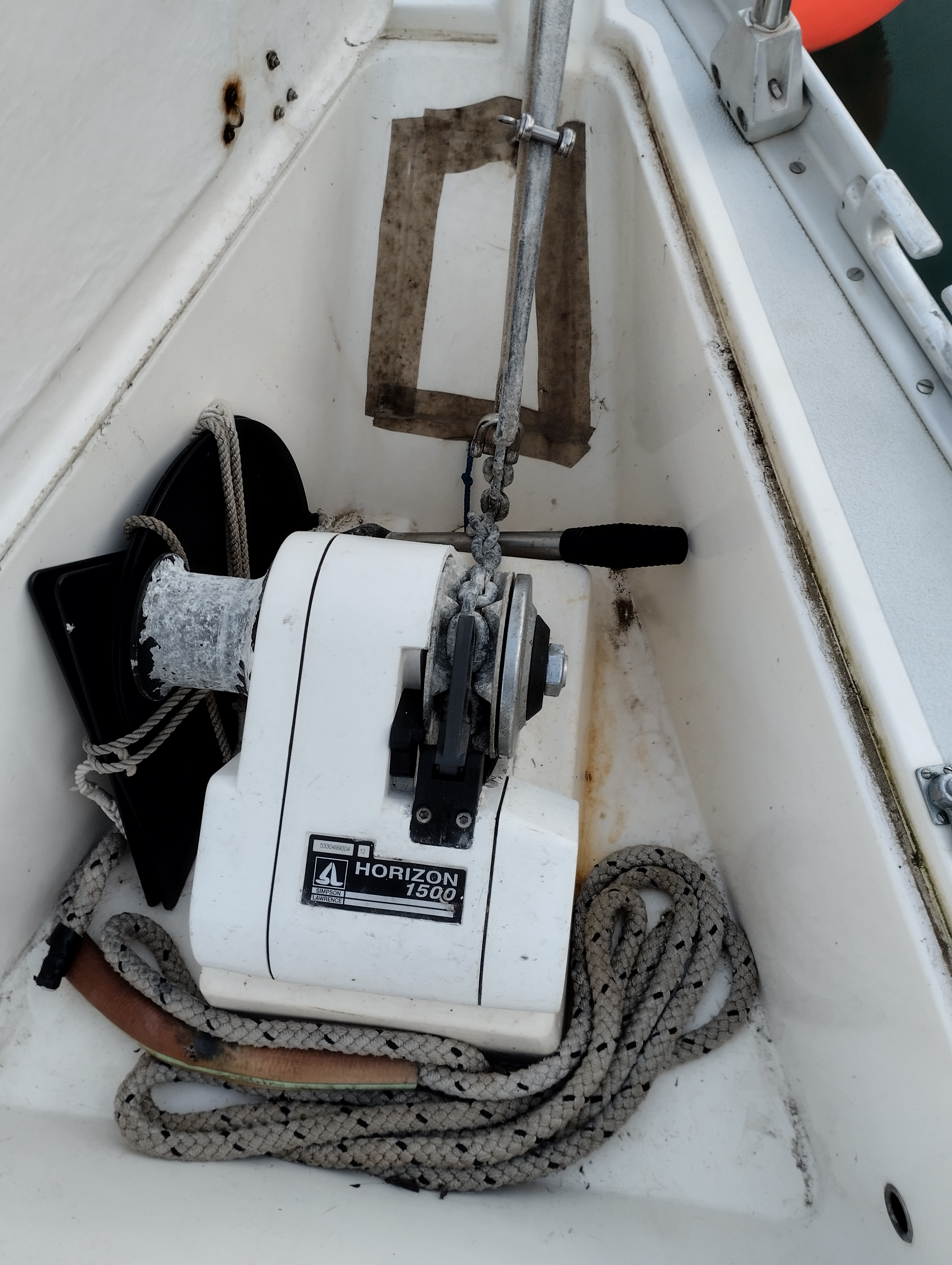

Thanks in advanceView attachment 32806
Hi Ilbon,
No problem, my windlass was fitted with an 8mm gypsy as my old chain was 8mm. I have upgraded to 10 mm chain and a 25k Rocna. All this involved was changing the gypsy, which was a fairly easy 10 minute job. The hard part was locating the10mm gypsy, another member kindly sold me his old windless..
Looking at your photo I would say yours is 8mm, easily checked with a vernier across the link width.
Hope that helps
Bob
Hi Bob
thanks for your explanation, it does help.
Now you got me thinking...shall I upgrade mine to a 10mm, too? But then I realised your boat is an M42 while mine is an M35, hence a 10mm chain may be well oversized for my M35. On the other hand I will upgrade to a 20kg Rocna from my actual 15kg one, which I will use as a spare. Any comment on this will be appreciated.
I may take off the gypsy for greasing/maintenance, maybe there is some tag where the size is indicated. I will follow this "cheating note" for the measurements
Ibon
Ilbon,
Many years ago I had M34 and that had 8mm chain, I left the chain but upgraded the anchor to 20k. I never had any problems with this set up and always felt it was sufficient for my needs.
My M42 never gave any doubt with the 8mm but I’m off on longer trips including the Med so wanted longer chain and a larger Rocna, hence the upgrade.
I’m sure you will be fine with your upgrade.
Bob
That is great advice Bob!
I will do so, and if I do more regular sailing I will think about the upgrade, but for now...I will only get the 20kg Rocna..
