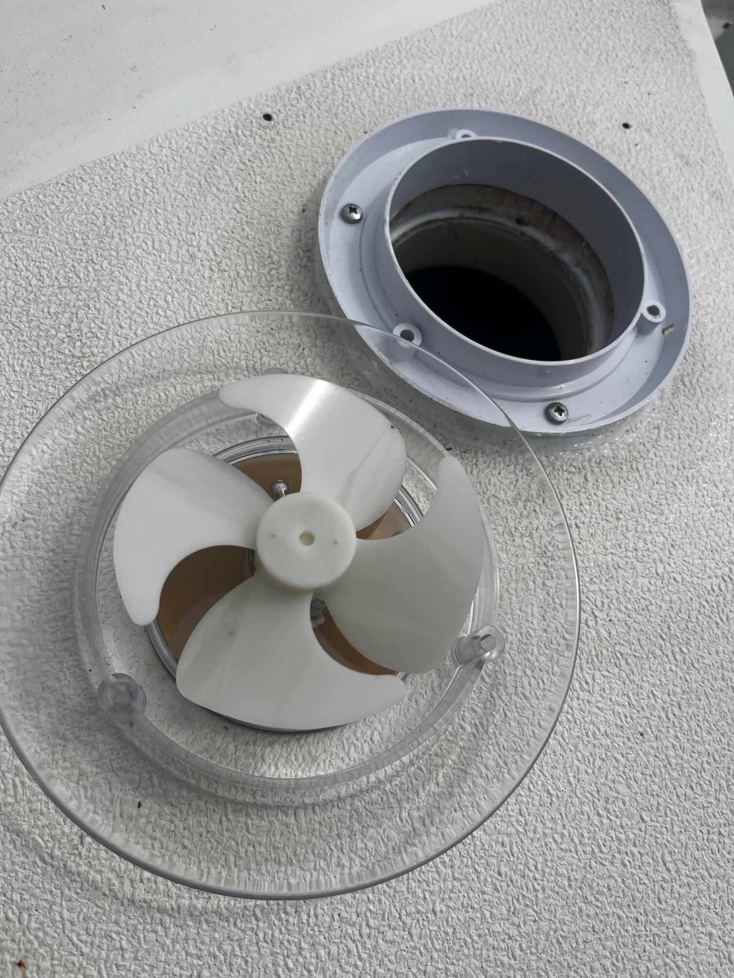

Hello - does anyone know where I can source a solar fan insert for the 9" ECS stainless roof vent? Or maybe have an old one kicking around?
The fans in 3 out of the 4 vents are still working fine after 35 years - but the 4th one is completely missing - presumably failed and removed by a previous owner.
I don't think ECS are around any more.
Thanks - Dave - david.lincoln@teknet.uk.com

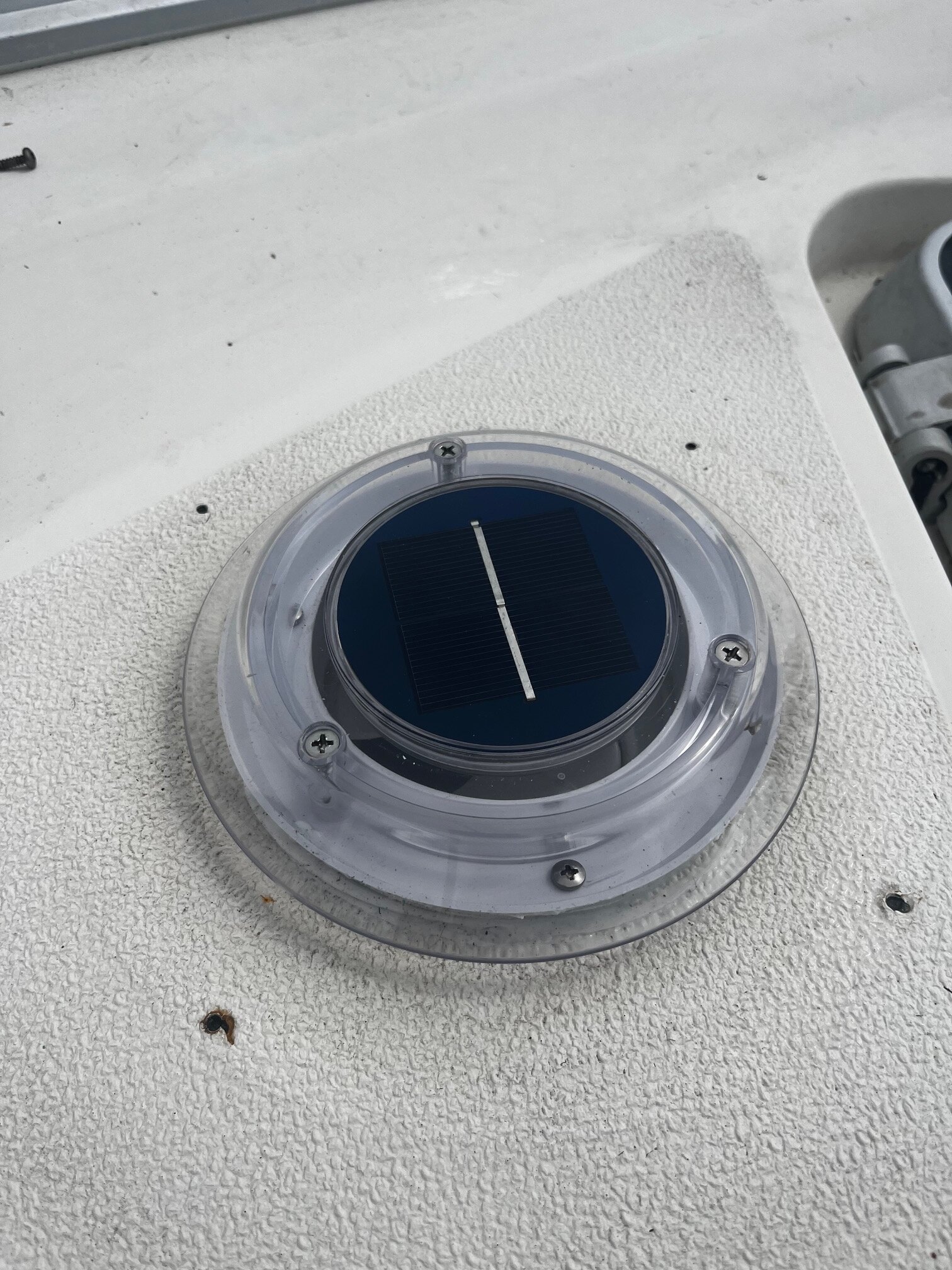

OK - so I've answered my own question!
The gubbins from the Osculati Ventlite Sunair Solar Fan Kit fits the old ECS Solar Vents perfectly. Keep the original stainless steel cover as the one in the kit is a different diameter - but all the bits fit just fine.
Job Done.
