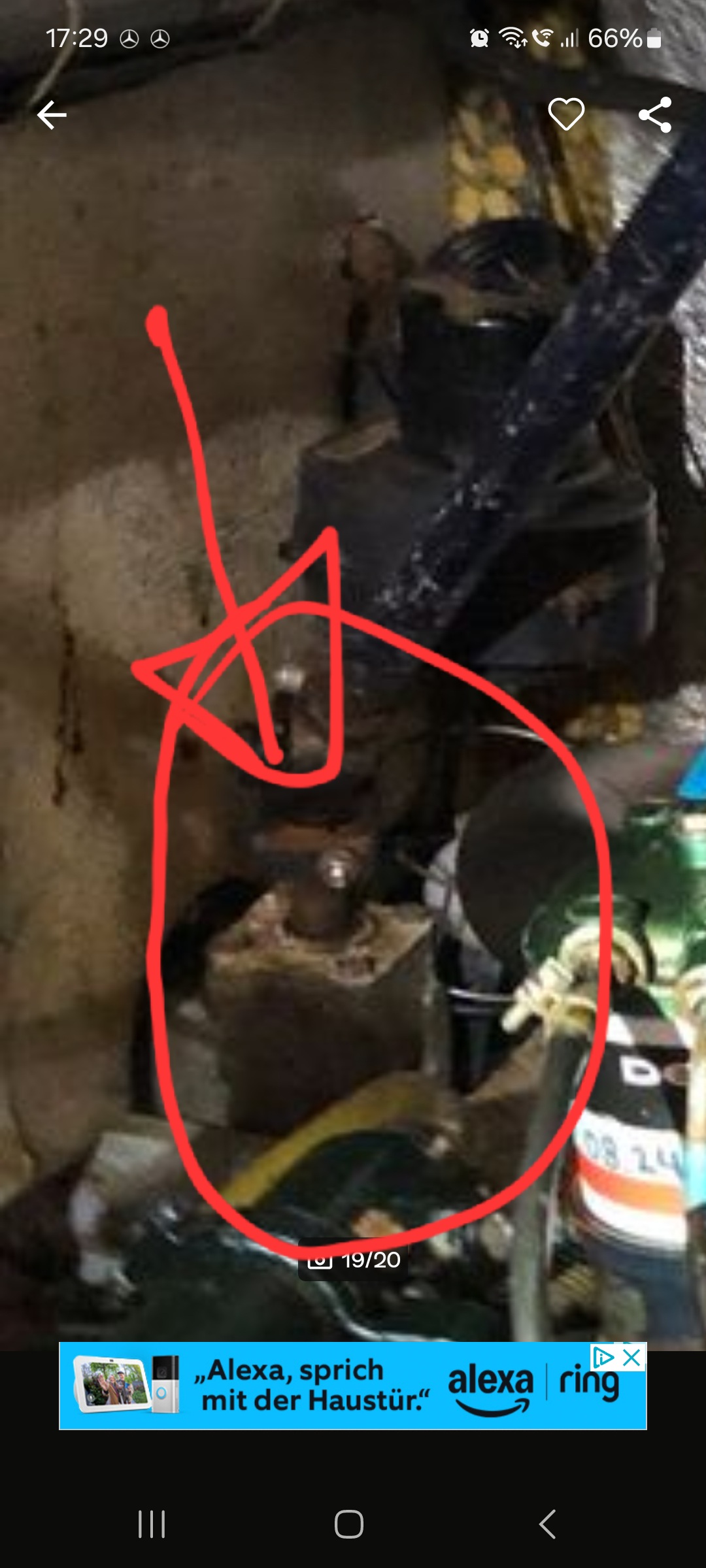

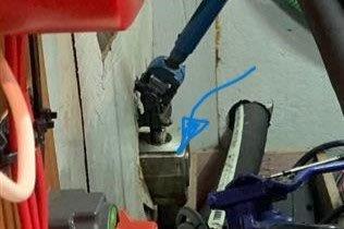

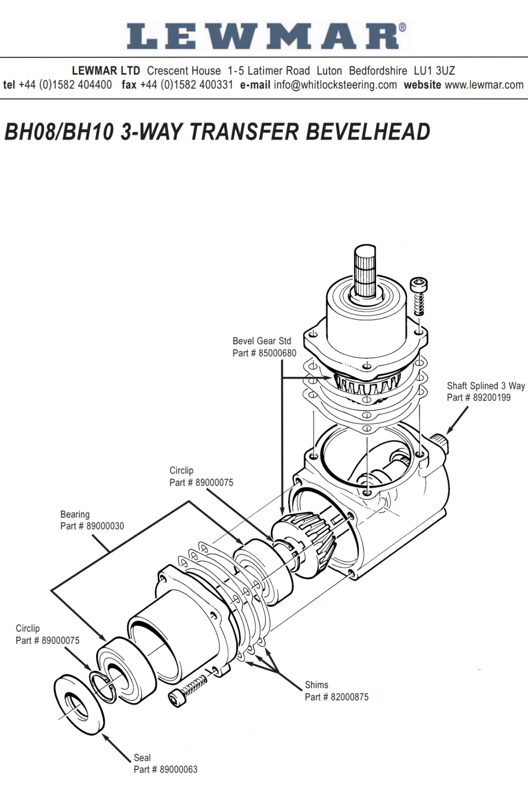

So für meine Moody 39 das Winkelgetriebe für die Steuerung. Im Bild gekennzeichnet
Hat jemand eine Idee wie ich so einTeil herbekomme.
Danke im Voraus
For my Moody 39, here's the angle gear for the steering. It's marked in the picture.
Does anyone have any idea how I can get a part like that?
Thanks in advance

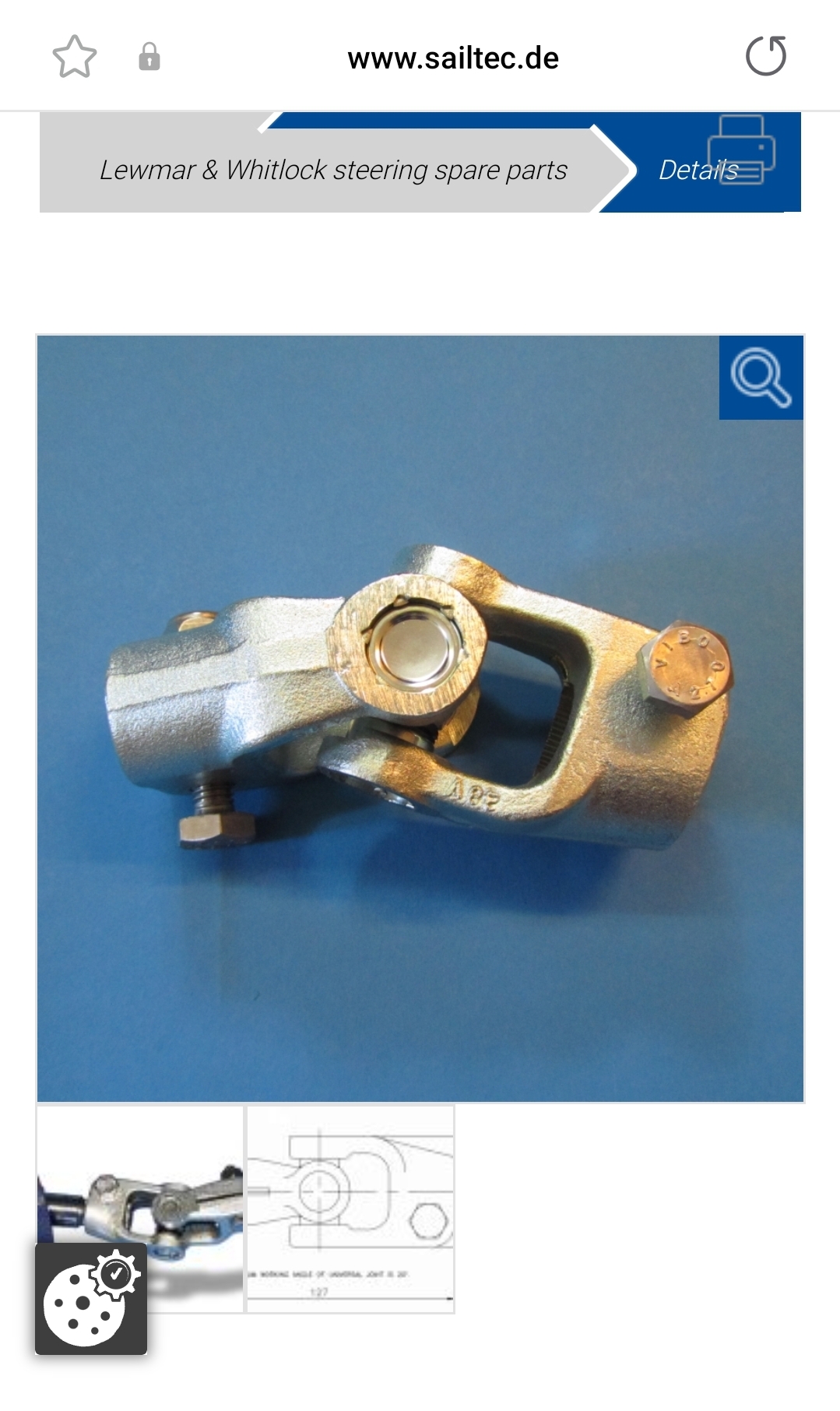

Uwe,
I am not familiar with the M39 but in the uk we would call this a 'universal joint'. I hope this helps your search
Paul

Es geht auf ein Wickelgetriebe und dann weiter auf ein Lenkgetriebe.
Dieses Winkelgetriebe ist mir wichtig
Wo ich sowas her bekomme.

Nein darunter ist das Wickelgetriebe.
Die Kreuzgelenke habe ich.
Hi Uwe,
If it's a Whitlock system, the man who will know how to get one is Cliff Mogridge of Yacht Steering Services:
I think he's a one man band, so very busy and not the easiest to contact, but he certainly knows all about Whitlock steering systems.

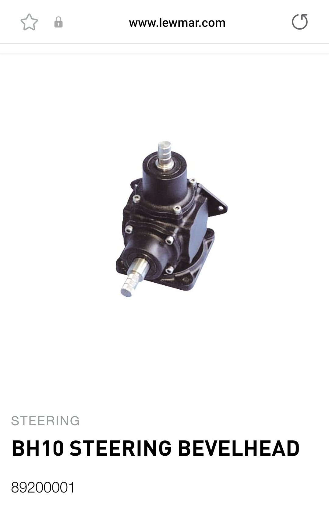

Hi,
I think Uwe's is a simple bevel head, one input and one output, rather than the 3 way shown in the exploded view (two inputs one output or one input two outputs).
Problems with wear on these bevel boxes can often be cured by careful measurement and re-shimming. Bearings and seals can be replaced with parts from Simply Bearings rather than paying Lewmar prices.
