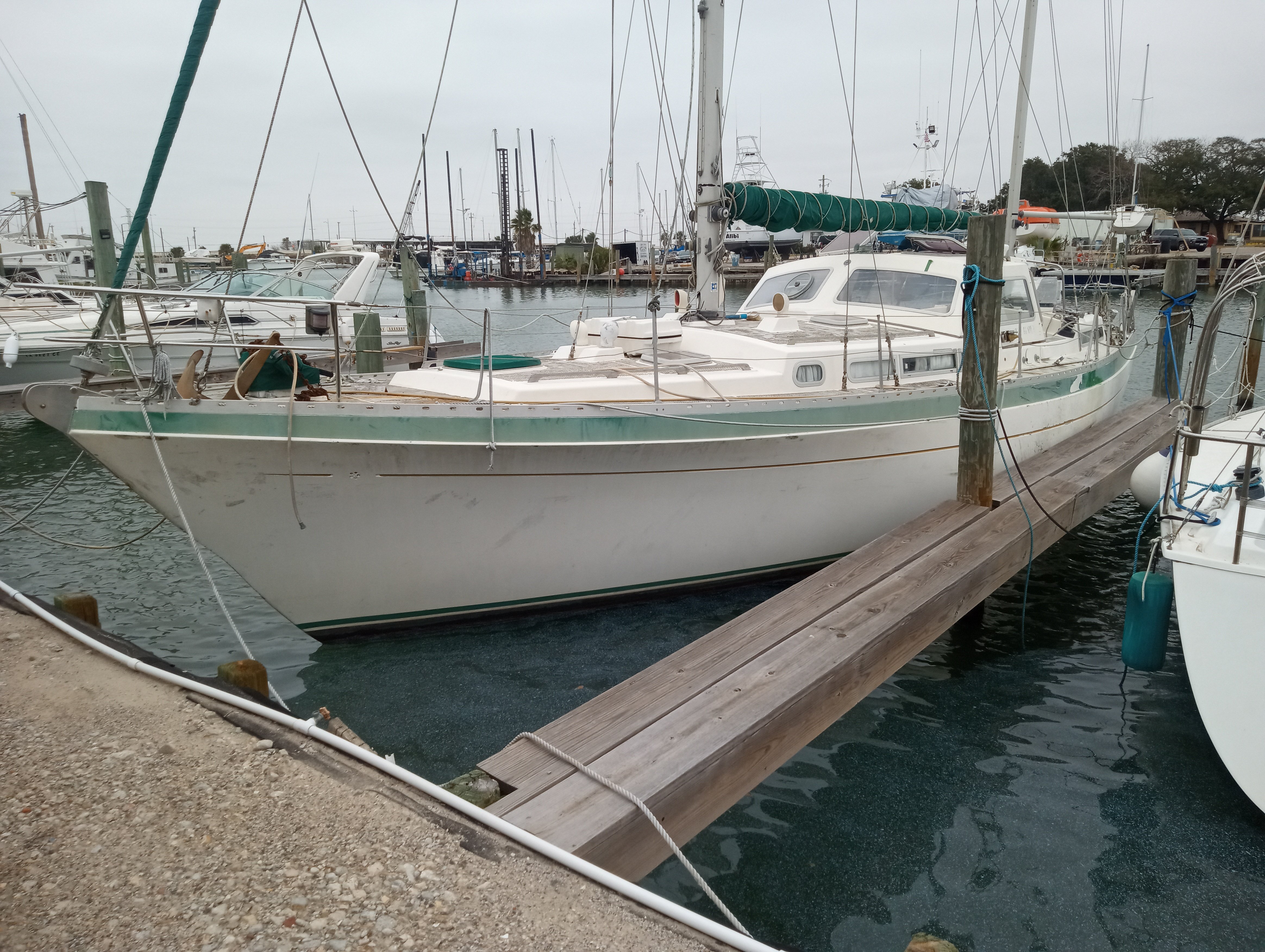

I am considering a 1978 Moody 42 CC. Is the keel molded integrally with the hull or bolted on. If bolted, will I have to cut through the interior liner to access/inspect for condition? This vessel has not been hauled since 2016 but other than minor storm damage, she shows well otherwise from the waterline up.

I have worked in and around marinas/boatyards off and on since the mid 70's. The vessel I'm looking at is the first Moody I have encountered. She is certainly stout and now that I have an idea of the underwater construction, finding the source should be a bit easier once the haul out occurs. Thanks for the info!
