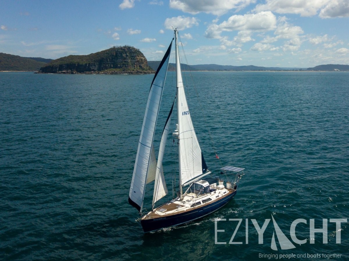

Hola Miguel, (supongo que eres quizas Español?)
The sail set on the inner forestay of a cutter, whether self tacking or not is known as a staysail. The sail set on the forestay, if cut with some overlap and a high clew, is called a yankee, the name of the first yacht to deploy such a sail. Typically, a yankee has less overlap than a traditional genoa, as it is overlapping both the main and the staysail. Before yankees, a cutter would have carried a working jib on the forestay.
The normal way to sail a cutter is with both staysail and yankee set - she shouldn't need a full 150% overlap genoa - and, as the wind gets up the yankee is progressively rolled up and the main reefed, She should balance brilliantly in a gale with just the staysail and double reefed main. Often, the staysail is provided with a deep reef, so you can use reefed staysail and triple reefed main in place of storm jib and trysail, although this still leaves a boom crashing about which is perhaps not the best for Southern Ocean storms.

Gracias Peter, (or obrigado as I am Portuguese ) for yet another educational insight on nautical terminology. In the attached picture you can see Madrigal's in all her glory. A great set up offering many options for different wind conditions. Really hoping a typical southern ocean storm is not one of them any time soon.....

Hi Miguel,
I'm sorry I guessed your nationality wrong, I'm afraid I don't speak much Portuguese. n joining the MOA, you will find other members who sail in Portuguese waters.
I trust your purchase will complete quickly so you can get to know your new yacht soon, she looks beautiful in the photo. I must ay, itlooks to me rather as if she has a full genoa set together wit the staysail which, in my experience, is unusual. I wonder what other M46 owners think?
As a guest, I'm not sure whether you get access to the Moody Archive. In case you don't, I'll replicate tha ail area data for the M46 from there:
SAIL AREAS
Inmast Furling Mainsail
41.0m²​
441 sq ft​
Furling Genoa
65.0m²​
699 sq ft​
Cutter rig yankee
52.5m²​
565 sq ft​
Self tacking staysail
19.6m²​
210 sq ft​
You can see from that why I consider Yankee plus staysail plenty of area in the fore triangle - considerably ore than the genoa by itself and I fear that Genoa plus staysail would leave her a bit unbalanced. Again the views of those with real experience of a M46 would be welcome.

Hi Peter, nothing to apologize for.
You are correct, she has a full genoa and that is what triggered my question about the inner stay/stay sail in the first place . For the most part a furling full genoa should handle most "pleasant" wind conditions without the need for a stay sail. Of course , and for the reasons you mentioned, it would be very handy to have a stay sail on longer passages for the flexibility it offers in particular under heavy weather. Either way I will stick with the current set up until such time I have a good feel for her and therefore able to make an informed decision.
