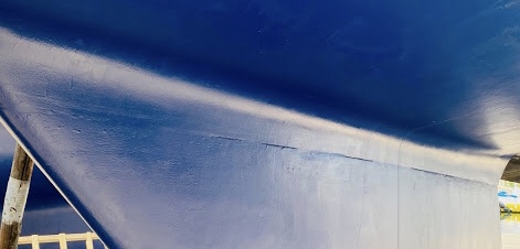

2) Keel fixation (studs and nuts) as well as keel-hull joint? From the pictures of the hull (antifouled) attached you can see partial short lines and also little space in some areas in between the hull and keel joint, which are not covered by the antifouling paint. Is it really an issue to worry?
