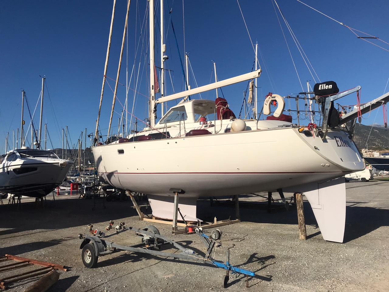

I am about to buy a used Moody 46 and I would like to get the dimensions of the sails so I can replace. They are all furling so am considering triradials but need the dimensions to get quotes

Hi Mike,
From the Moody Archive (link towards the bottom left of the Home Page):
I= 17.70 m. J=5.29 m, P=15.90, E= 5.15m.
That's all a sailmaker needs to give you a quote for a sloop rig. I'm afraid that, if she's a cutter the Archive has no rig dimensions to help you with the staysail, but does give areas:
Mainsail 41.0 sq.m., Genoa 65.0 sq.m., Yankee 52.5 sq.m. Staysail 19.6 sq.m.
While those areas don't let you design the sail, a sailmaker may consider that enough for a quotation.
No benefit from a triradial for a furling main - the sail needs to be pretty flat to avoid fouls when furling. You need to think about whether you want a roach and what length battens go with it. No battens need a negative roach (hollow leach) short non overlapping battens zero roach (straight leach) full height battens full roach. Note that an in-mast furling main obviously has vertical battens , if any.
Triradial for a genoa is a good call imho. but you will need a padded luff with it, to keep it flat as you reef.
If she's a cutter, I would go for a triradial yankee and cross cut staysail.
